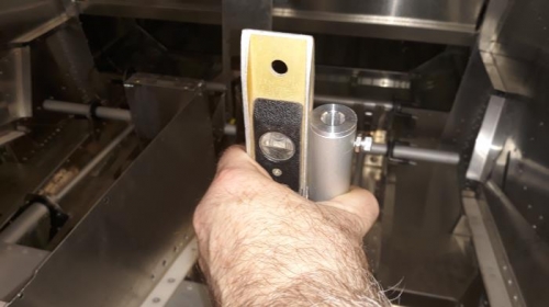

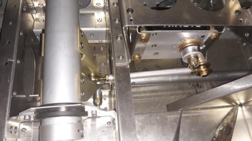

I leveled the stick and then test fit the aileron pushrod, while adjusting its length. Both rod-ends supplied with the Garmin kit are right-hand threads, so you can't turn the shaft like a turnbuckle. This took a little more time because of the threads and the tight space to work while stacking washers.

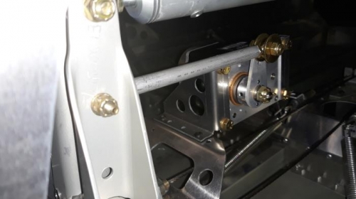

I centered the elevator throw and installed its pushrod as well.
leveled stick to get mid-throw
aileron  pushrod attached
elevator pushrod attached.
