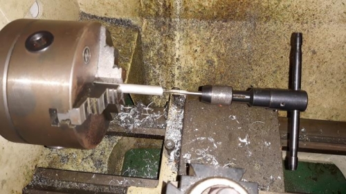

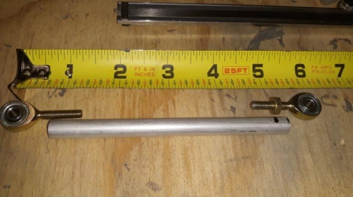

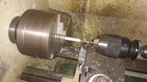

I cut the first pushrod a bit too long mistaking the attach point, so I re-measured and cut both rods to the correct length. I then drilled and tapped both end for the 10-32 eybolts / swivel rod-ends.
measure twice, cut twice
tap drill
threading for 10-32
