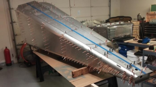

Brief Description:  1 - Installed top skins and riveted bottom of tail
I installed the top skins with clecos, turned the assembly on its side and riveted the ribs and side skins to the bottom skin. I taped over the rivet holes for the middle longeron to see if it will slide out after I rivet the side skin. If it does, I can go ahead and rivet the right side this way as well, and then slide the new longeron in place when i receive it.
not riveting the middle longeron yet

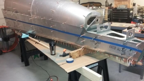

turned on side to rivet bottom
bottom is riveted
bottom is riveted
