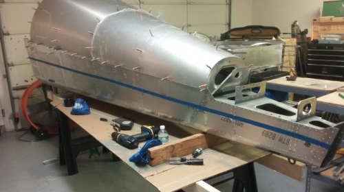

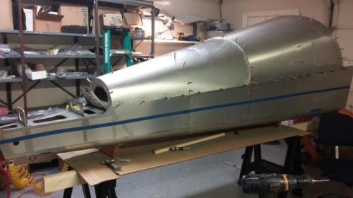

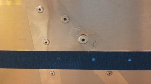

I riveted the left side, and just as I had figured, I can easily pull the middle longeron out without any trouble. I then riveted the right side the same way. I had two damaged holes in the right side of the skin from when I rolled the tail cone over on its side. Apparently two clecos caught on the bench and were wrenched out of the holes. I hammer them areas flat, drilled out to 3/16" and install a 3/16" rivet in each hole.
