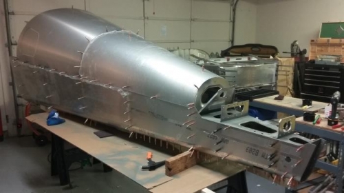

I removed the plastic film from the inside of the top skins and clecod them in place to so that all the skins are in place before riveting the side skins. The top skins will be removed afterwards to allow easier access for installing wires, control cables and antenna coax.
Temp install of top skins

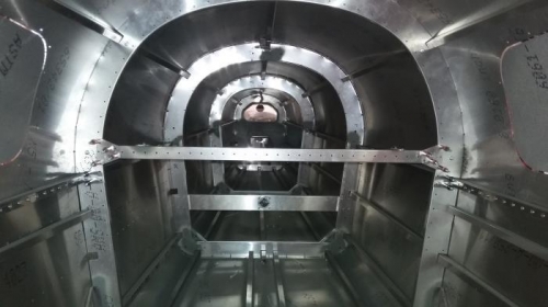

tail cone inside
tail cone inside
