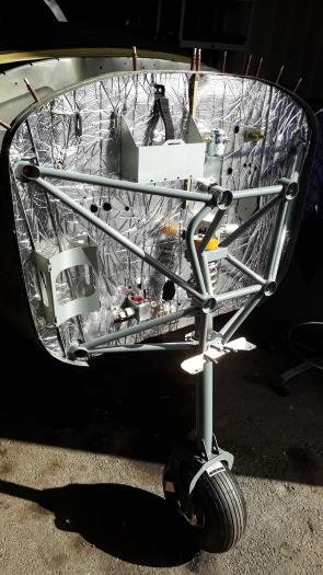

2 - Installed motor mount / front wheel assembly
I installed the motor mount / front wheel assembly to the firewall, torqued the AN5 (5/16") bolts to 11.6 ft-lbs, and then applied torque seal to the nuts.
Motor mount / front wheel installed
