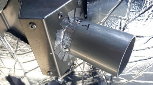

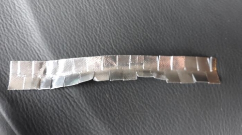

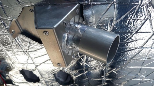

I measured and notched a piece of hi temp foil tape, applied it around to gap around the duct pipe, and then finished the seal with another piece of tape.
notched tape for duct
applied notched tape
completed seal
