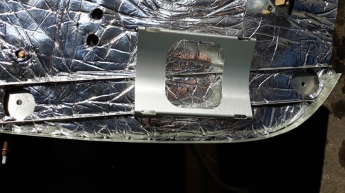

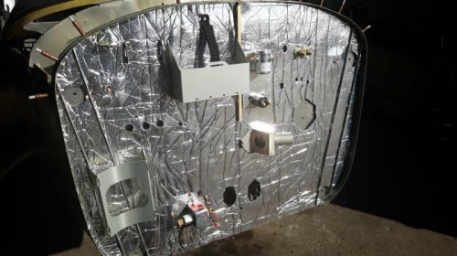

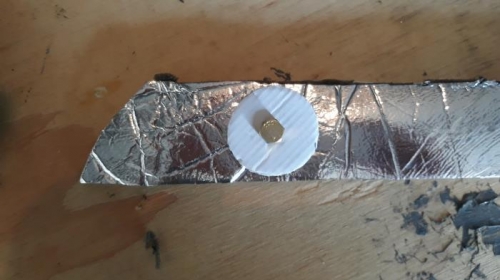

I used a 2" template to cutout the holes in the firex material for the motor mount, installed the side pieces, motor mount pieces and then then main firewall piece. I then temporary mounted the battery and starter solenoids.
I also drilled three extra holes in the firewall and installed grommets for possible wire routing of the shunt and the electric fuel pump.
cutout for motor mount
installing motor mount strips
firex installation complete
