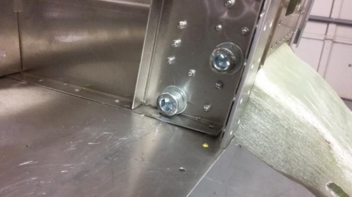

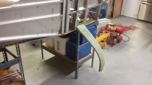

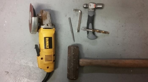

I installed the main landing gear by positioning one side first with one bolt, lifted the other side and couldn't get the bolt in so I made a taper pin out of a drill bit (from reading the notes on the instructions.) I drove the taper pin in with a hammer and followed it with the socket head cap bolt. I then drove in the other bolt on the first side and it was very tight. I actually had to "thread" it through the exit hole a bit.
The last bolt was a no go. The entrance hole was fairly close aligned, but the exit hole was off by quite a bit. I must have not drilled it properly so after much useless hammering I ran the drill bit through one more time and opened up the exit hole. Perfect fit.
Tools needed for
Tools needed for "coaxing"
Ha! First side is easy.
Bolts in
Bolts in
