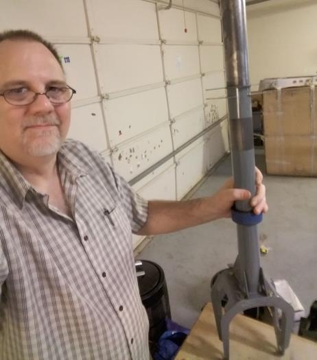

Brief Description:  Assembled front landing gear fork
I assembled the front fork to the shaft. I couldn't get the thrust bearings on the shaft without some interference; some of it due to rust from sitting in a box for 3-5 years, and some of it may be out of round. I ordered some 320 emery cloth so I can take it down a few thousandths.
Front gear fork
Front gear fork
