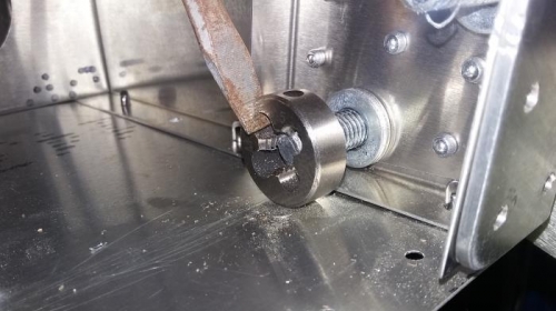

After all the coaxing some of the bolts had some dinged threads so I chased them with a M10x1.5 theading die. No room for the proper wrench so I used a flat blade to turn the die. The nuts spun on nicely after that. Main gear on and ready for wheels!
chasing threads with M10x1.5 die

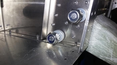

Hand tight nuts
Hand tight nuts

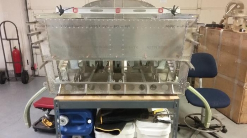

Mission Accomplished!
