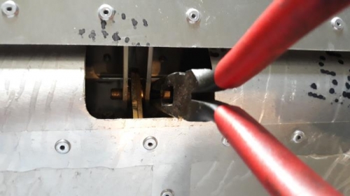

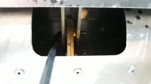

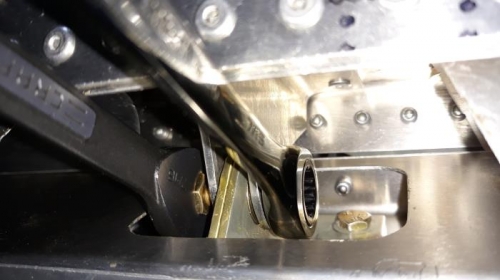

Brief Description:  1 - Installed elevator hinge bolts
Having the right tools for the job makes life so much easier and the work goes much faster. I bought a set of box-end ratchet wrenches for the tight space on the elevator hinge. I used grease on the internal washers to make them sticky, and used a right angle hex key to hold everything in position while I followed it through with the bolt held by needle nose pliers. I used the needle nose pliers again to insert the last washer and hold the nut while I tightened the bolt with the ratchet wrench.
rachet box-end wrench does the trick
right angle hex key holds position
needle nose pliers to insert bolt
