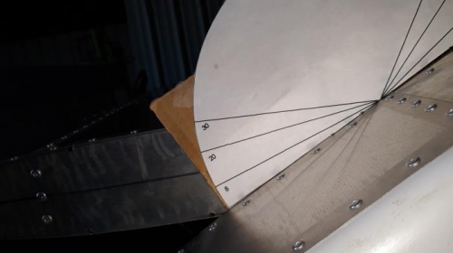

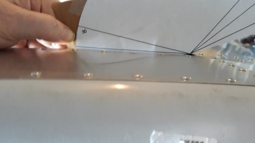

1 - Set elevator deflection angles
I set the elevator deflection angles according to the manual, 20 deg down & 30 deg up, by adusting the length of the elevator push rod and then tightening the locknuts on the rod ends.
20 deg nose down
30 deg nose up
