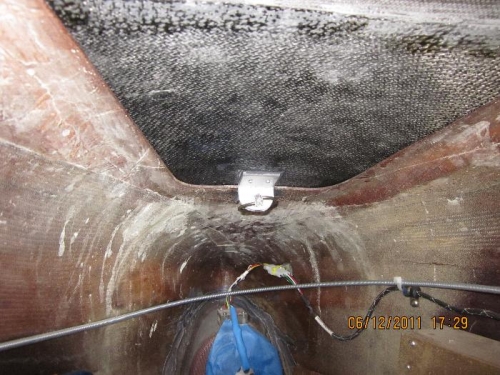

Fabricated forward nose hatch latch from angle aluminum, pop rivets, and structural epoxy. Hatch is held down with a clevis pin. Found the operation to be unsatisfactory due to too much play in clevis pin. Will reconfigure to 2 hold down screws at a later date.

Nose hatch latch
Nose hatch latch
Nose hatch latch
Nose hatch latch
