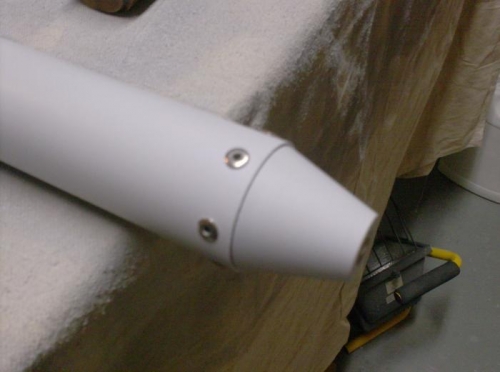

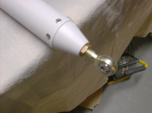

Checked to insure all of the push rod components were dry and then coated the rod ends with a little BoeLube and gently inserted and tapped them into the push rod tube. I then blind riveted them on and inserted the rod end bearings.
Rod end riveted in-place
Rod end bearing
