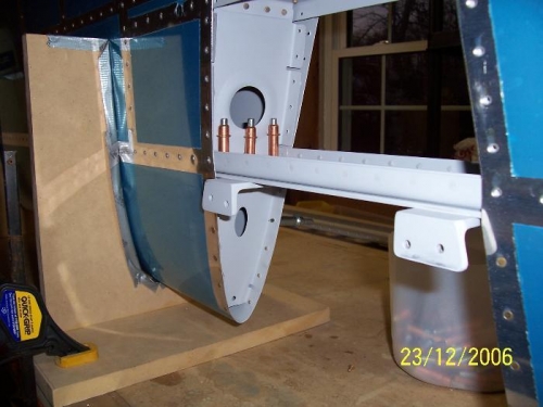

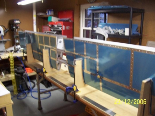

Riveted the front spar to the nose ribs. Per the plans, held off riveting the two most inner ribs as there's no clearance with the HS in the cradles. At first I was going to have my wife hlep me shoot these rivets becaus half of them are not readily accessible when holding the bucking bar with the left hand. But after thinking about it for most of two days, I went back and tried it solo. I discovered that with a little practice, I can shoot with either hand. I then installed and riveted the remaining inspar ribs to the spar.
Front spar  in-place
Front spar in-place

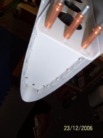

Close-up of the  spar clecoed to a nose rib
