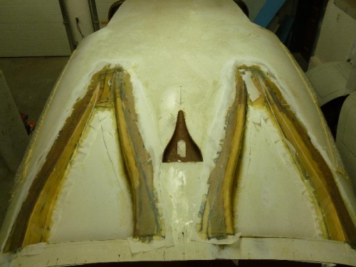

Brief Description:  NACA Scoop has 2 bid on top
Here I had to add 2 small TRIAX strips on the top to fill in the depression in the fuselage.
Then I laid down 2 unidirectional strips of glass cloth to tie it all in and finish it up for strength. Once in place I used Dacron fabric known as Peel – Ply to soak up excess resin and feather in the edges.
Peel -  Ply on bid
Peel - Ply on bid
