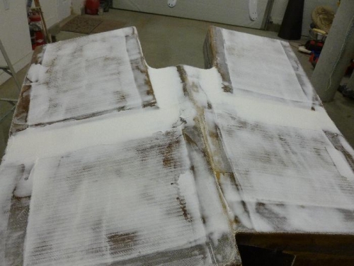

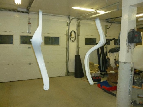

Brief Description:  Clean up bid, sand micro and add, sand fill prime
I had some bid trimming to do then sand the top micro and saw I needed more so that was applied. Then it was time to work on the main gear legs so the pinholes were filled and the legs sanded and now it was time to spry on smooth prime 4 coats will be applied and 2 sanded off to get the other pinholes.
Filled, sanded and smooth prime
Sanded and micro added
