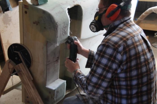

Today finished trimming the final Chapter 07 reinforcements around the rear bulkheads. Sanded off the dickey wraparound bubble at the firewall on the 2 x BID I had previously forgotten. Applied a 2" tape over the site.
Trimmed seatback map pocket. Noted the slot above the heat duct probably needs taping as well. Next time I have micro.

Trim, trim
Trim, trim
