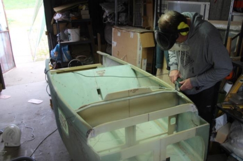

Brief Description:  Trimming the sides
Still feel like crap. Very little voice, coff, coff, coff.

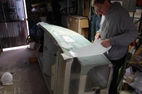

Rip off all that lovely peel-ply and trim the edges with multi tool, file and sandpaper.
Remove side window brace.
Trim line duct tape on the first side had been affected by the epoxy and would not pull off. Had to clean up with sandpaper. Looked nice afterward and all layups good!
