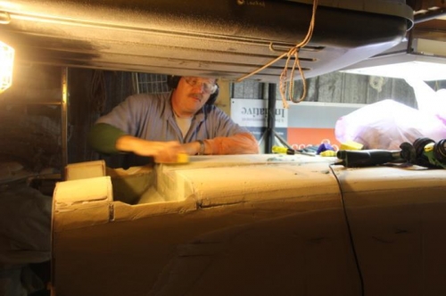

Trim NACA
NACA layup not particularly good. Some bubbles and voids.
Trimmed NACA layup, prepared flox corner.

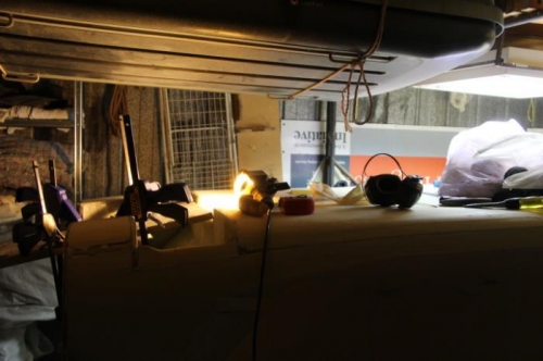

Hit bubbles with hot air gun, injected raw epoxy & clamped flat.
Trim NACA layup
Rear NACA clamped flat
