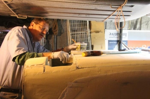

Glassing NACA
Use some crappy urethane to make a form in the forward NACA, attached with bondo, to make sure the glass stands up.
Layup both bits of NACA. 2 x BID.
Layup NACA
