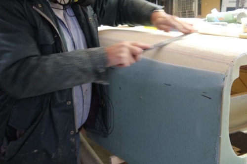

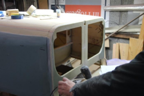

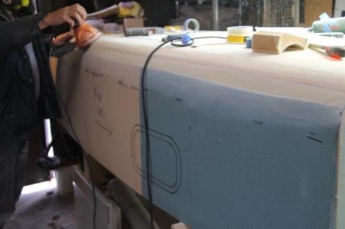

Brief Description:  Ongoing shaping of bottom profile
Ongoing profiling. On protruding wood/micro the bastard file seems to do good work.
General shaping the random orbit sander does well, but needs a visit from the file to cut down the micro. Template just not working for me, if 1/4" of wood visible can't achieve the template, longeron is too low. Used template as a guide to make a nice rounded shape.
Routed foam around landing brake and F22.
4th cut with a bastard file
5th, Random orbit sander
