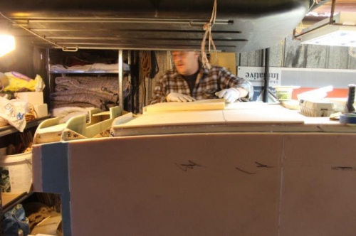

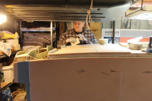

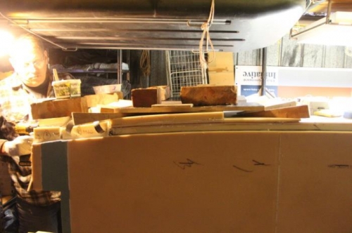

Install NACA foam
Install NACA foam, required complicated weighting with wedges to stay flat.
Foam around MLG Bulkheads micro'd on as well.
Joggle for MLG cover ignored, I'll be installing a Wayne Hicks style flush cover. Bulkheads have been upsized 1/16" to achieve this.
3/8" stuck on
On with the 1"
All done
