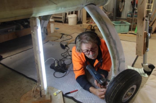

Brake heat shields
Remove main wheels, and formwork, and make glass cutting templates for heatshield flanges.
Do a bit of trimming, but leave them way oversize.
2 x BID over outside surface of flanges, overlapping 1" onto struts.
Noted a bit of corrosion on the outside of the brake caliper, so polished it up and painted it.
Trimmy, trimmy
