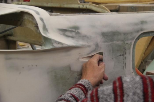

Brief Description:  NACA air vent inlets
Over the last week broke the NACA form into 3 bits getting it out, rebuilt it, strengthened it a bit taped it up and repeated the fill process portside.
Sanded the fill, re-filled some low spots and bubbles, and profile sanded afterward.
More leftover fill onto the canopy bottom. Whilst I was there I patched some bare foam at the aft corners with 1 x BID. Start to cover the exposed foam at the aft cutline, but find a reference in the plans that it should be excavated 1/4" first, so do so, and backfill with flox rather than the plans micro. I would like my outer skin to stay attached to the inner... Find one delam and hock that out further and flox it up.
New Improved More-NACA-like air vent
