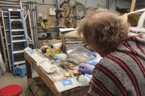

Elevator bottom repair
Prep sanded again, and taped off re-fill areas.
Layed up 2 x UND patches to match original plies with a 1" overlap, with 1 x 4oz over all and peel ply. 2 x UND patch on damaged counterweight attach.
