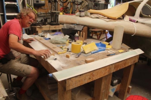

Profile sanded elevator tops with 36g longboard, then hollowed out the trailing edge to match the profile with 36g glued to a 5.5" plastic pipe section. Did the details around the counterweight with 120g on a hand block.
Refilled a couple of low spots and the larger of the pinholes.
Sanding to profile
Sanding to profile
Refilling back to the profile
