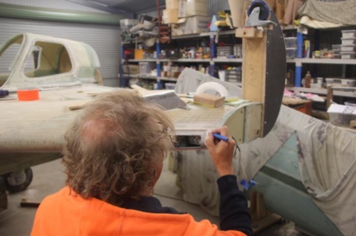

Finish sanded starboard aileron down to 320g wet, removed the tape on the bottom, (which caught most of the drips). and it looks lovely.

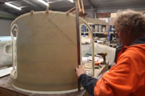

Did some more figgering on the window frames, and continued the fill/profile/refill for a while.
Finally noticed that my fixed turtleback drip rail was interfering with the position of the free part. Cut off the offending part, and kept trimming until it sits properly. There is a gap remaining, but I'll worry about that when the forward frame is complete.
Tested the window placement for the nose gear window, and it not optimum! Leg gets in the way. Move it???
