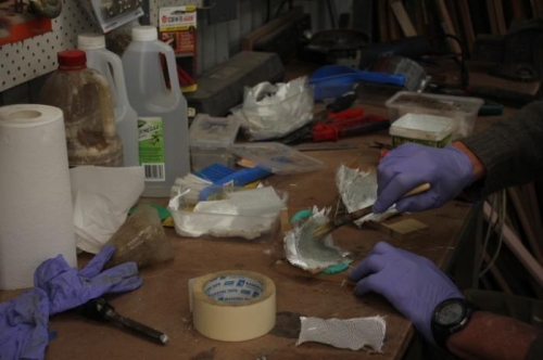

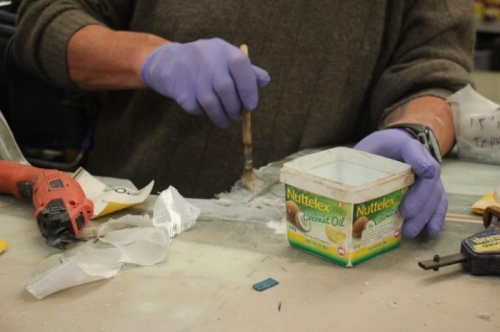

I have noted that part one of restoring the port spar cowling flange it to build the wing flange up at the leading edge to place the cowl at the correct level.
Layup 6 x UND tapes 90/45 at the leading edge, tapering back to zero where the level is correct. 1 x BID over repair and peel ply.
6 x UND tapes 90/45 over the cowling hinge button forms, peel ply above and below.
