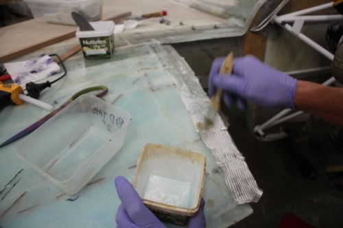

Applied 1 x BID over the wing cowl flanges upper surface, and peel ply edge.

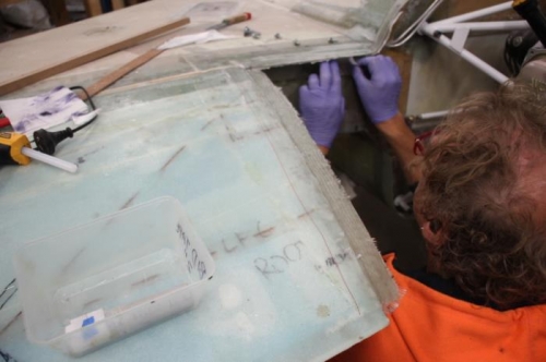

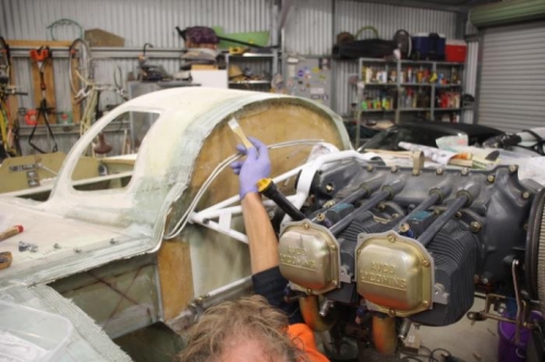

Am perplexed by the hand amendment to the layup schedule for the brace from the inside of the upper cowl flange to the rear face of the firewall and the spar. It was originally 1 x BID, and has been hand amended to 5 x BID. I believe this will have a tragic effect on fitting the cowling it, and I'm just not going to do it. I whack in a flox fillet to help with the transition and layup 2 x UND overall using tapes cut on a 45 degree bias, the plies crossing at 90 degrees. I padded this with 2 x BID in the sharp corners. This was an excruciating layup with the engine fitted. I'll do the lower flange reinforcementwith the engine off. [Timewarp: The flange over the strakes seems as strong as, but the flange on the turtleback is a bit bendy. I later added another 5 x UND at 90/45 in the wobbly bits].
Reinforcing the wing cowling flange
Taping the strake/turtleback cowling flange to the spar/firewall
Contortioning...
Contortioning...
