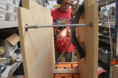

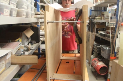

I have another name, but he is apparently a really busy man, and he is in Latrobe Valley. I decided to do some of the legwork myself. Research indicates the hardest bit is cutting and notching the tubes, so I bought some mild steel tube of the right spec and started cutting to see what happens. What happens is you end up with tubes that are too short and still the wrong shape. Any adjustment I make increases any existing gaps. Any attempt to transfer the shape to a fresh tube usually ends in a 180 degree error in placement and a tube that is even shorter.
I rough cut the tubes with a thin blade on a grinder, and profile with a flappy grinding disc on another grinder. Thi
I think it is supposed to look like this. Lets try tube 2
Grindy, grindy
Grindy, grindy
