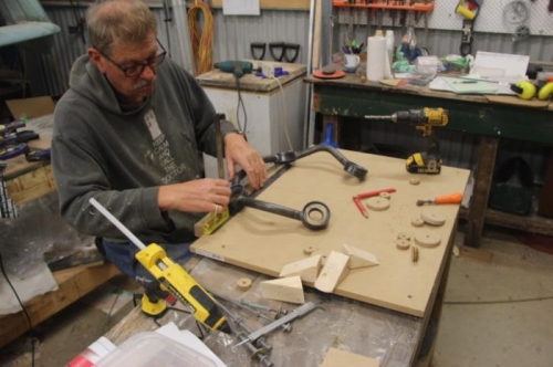

Manual Reference:  23-02
Brief Description:  Engine mount jig

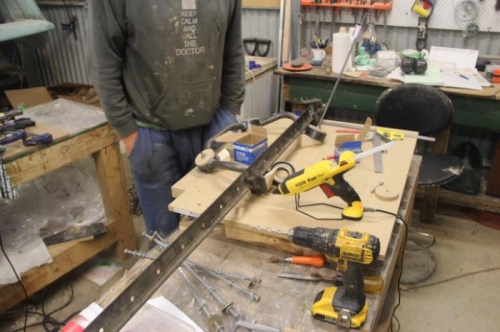

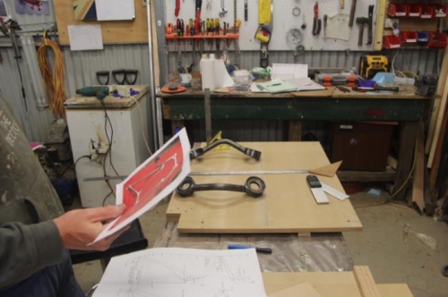

Fiddled with the engine mount jig for a while. Cut some 30 degree wedges to locate the dynafocal cups, and made some spacers to jig them. Hot glued the upper wedges to the jig. Bolted the cups with spacers with some threaded rod. Boofed the lower cups together a bit to make it all square.
