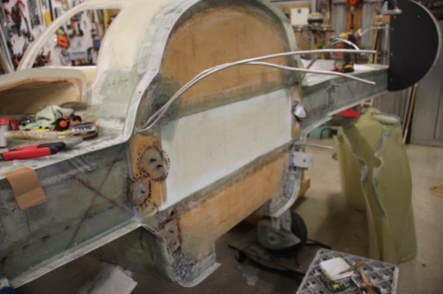

Brief Description:  Rudder hardware clickbonds
Remove port rudder hardware, make some changes and use the same brackets to install the starboard rudder hardware clickbonds.
Tape up the port clickbond threads and slap on 2 x BID reinforcement. (I think 1 x BID would have been enough). Peel ply over. I was going to bolt on the left rudder hardware to hold it flat, but I don't have enough non-aviation nuts. Push some taped mudguard washers over the result, and keep them flat as they cure.
