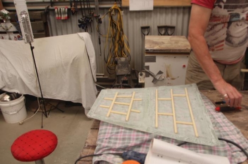

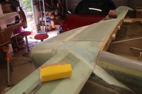

Shaped the pour foam, and was suprised to discover a fine looking profile was achieved by eliminating most of the foam outside of the dip.

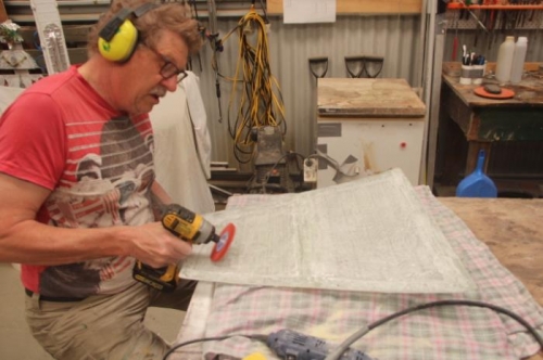

I though this would help with the rigidity, but it is still too flexible. Started cutting some internal ribs out of 1/4" H100. Prepped the inside of the door and stuck a couple on with urethane bond.
