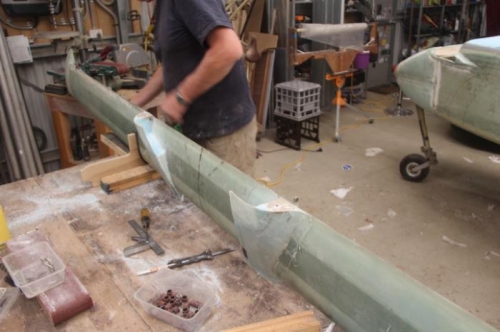

Removed canard and trimmed layup, all OK.

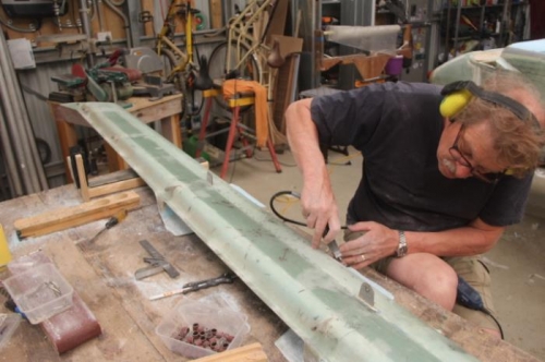

Hollowed out foam under open area of fixed canard, about 3" forward and outboard to the inboard edge of the rear canard tabs. Removed hot glue blobs and profiled the foam. Cut some flox corners.

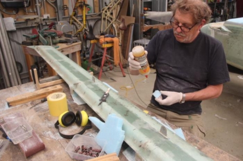

Stuck some slivers of foam into gaps, mainly in the leading edge.
Profiling pockets under the canard cover
Profiling exposed foam, cutting flox corners
Filling some gaps
Filling some gaps
