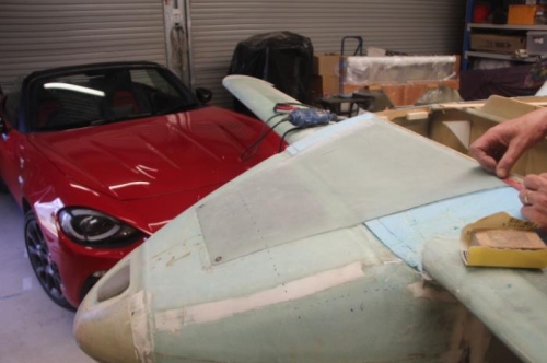

Trimmed some more and profiled door flanges. Profiled flanges for eventual taping of the joint, in an overlap fore and aft.
Recessed for K1000-3 nutplates prefitted to thin bits of carbon fibre, near the leading edge of the flange, for door retention.

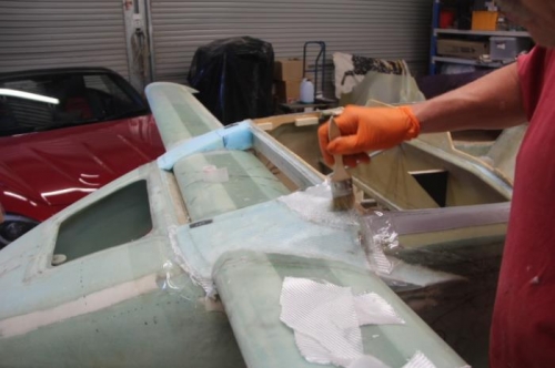

Prepped foam and applied 1 x BID tape along aft flange, 1 x BID flange over 'open' area, 2 x BID overall, overlapping 1" onto the canard, except 'open' area. Peel ply edges.
Profiling
Profiling
Wetting out
Wetting out
