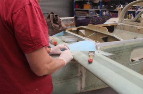

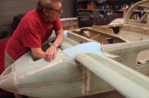

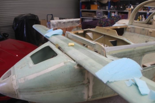

Trimmed all, refitted canard and contemplated. All OK.
Removed canard, uninstalled elevators taped fuselage around canard cover and reinstalled canard.
Prised off remaining foam blocks, prep sanded, and refitted with hot glue where foam will be removed, and urethane bond glue elsewhere.
Contemplating
Prising off the blocks
Sticken em back on
