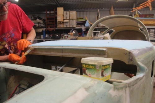

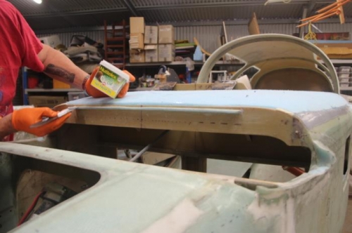

Nose door/canard cover
Prepped foam with runny flox, making a quasi-flox corner in the process. Wet out 2 x BID on peel ply and transfered to bottom of flange, overlapping 1" onto F28.
Prepping foam
Transferring BID tapes
