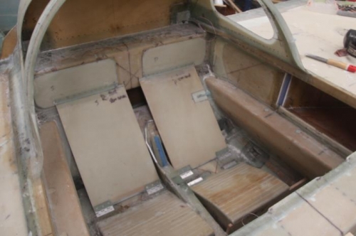

Trimmy trimmy, all OK. Very happy with the result. They sit closed, are comfy, even for massive me. They open, can be removed and refitted easily. Work fine with the armrests, and the armrests can be fitted/removed with the seats in place. Winner!

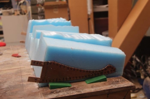

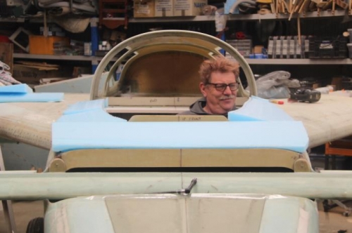

Haven't got firm plans for the canard cover yet, but want to look at it now, as I want to make sure the transition from the nose to the fuselage top blends smoothly through the canard cover.
Am really getting down the to dregs of my wing foam, with few usefull large blocks left. Assign what I have suitably for the canopy frame, then hot glue blocks together for the canard cover, cut the aft face square and fix the templates. Viki and I cut the foam later that night, after a few drinkies and a night out.

Hmmmmm. Nice view. COVID hair coming along nicely
