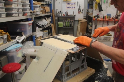

Popped off seatback assembly and discarded clampy thingies. Trimmed all.

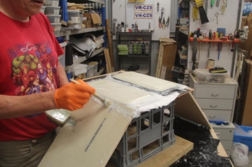

Made a jig to hold the seatback assembly at the desired angle. Filled remainder of upper seatback flox corner, prepped foam and applied 1 x BID, overlapping the seatback a generous 1". Maybe 2... Peel plied join. I used Colan BID just one more time, and I don't like it. It doesn't drape or wet out as well and unravells badly at the edge. I resolve to only use it where there is not an exposed edge or complicated transition.
Preppy, preppy
Preppy, preppy
Wetting out the BID
Wetting out the BID

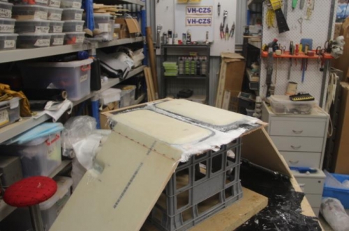

All done
All done
