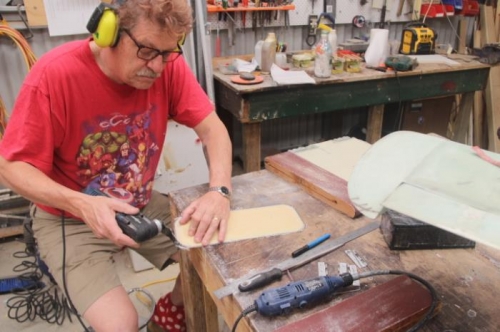

Trimmy, trimmy, all OK. Parts don't look any different to the slow hardener versions, but pot life was a problem yesterday, even with the shed at 17C. They are harder and less likely to delaminate though, for the cure time they have had. Hmmmmm.

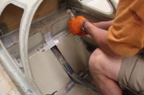

Secured spar hole covers to spar with dabs of hot glue, and taped surrounding spar. Installed floor hinges with BSC-44 rivets.

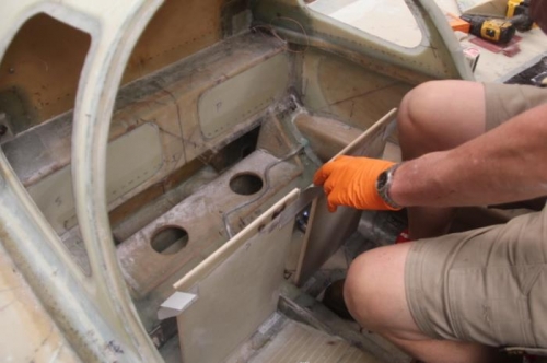

Trimmed seatbacks until they match the spar hole covers and look nice. Made some clampy thingies out of some old ridge capping and hot glued to the seatbacks.
Filled flox corners on seatbacks and clamped in position, hot glueing clampy thingies to spar face.
Wet out 2 x BID on peel ply and transfered to tape the join.
Trimmy, trimmy
Trimmy, trimmy
Filling the flox corner
Floxed, clamped and taped
