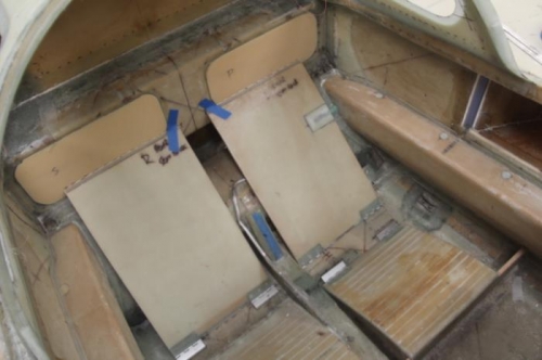

Drilled out and popped off offending hinges. Cut new -4 hinge halves for the thigh support and match drilled to existing holes in thigh support and re-rivetted. Fits!
Removed 1/4" of flange from the seatback hinges and redrilled seatback to match. Will need patching later. Adjusted the seatback bottom edge a bit, and reinstalled the hinge halves. Fits!

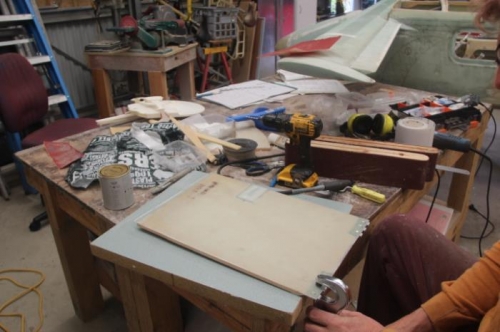

Spent some time last night, (in bed, really should have been sleeping), pondering the spar hole covers and how to secure them. I really want ready access through the spar holes. I understand they are brilliant for storage of stuff in the spar, so I'd like them no more difficult to get into then a glove box in a car. I decided to attach them to the seatbacks, so gravity will hold them in place!

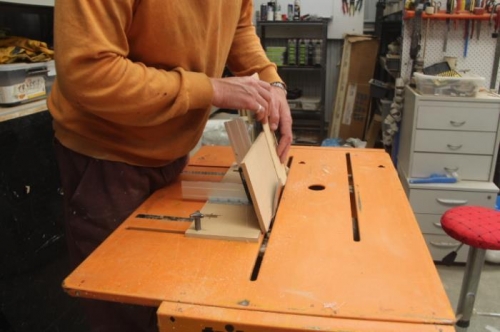

As this means they will have to be guarantee fit I decide to bevel the rear surface now, prior to attaching them. Not being in the best of moods I can't be bothered with the tedious methods I have used in the past, so spend some happy time making a bevelling jig for my table saw. Two bits of MDF, the guide piece with a tiny flange to support the work, joined by hinges, with the angle measured and locked in by a digital protractor. After some experimentation and test pieces, cut a 75 degree bevel on the foam, and they all come out lovely.

Trial fit seatbacks, spar hole covers  and thigh support
Bevelling foam, with the SpodBeveller 2000 (tm)
