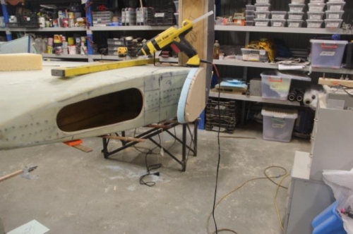

Brief Description:  Front thigh supports taping

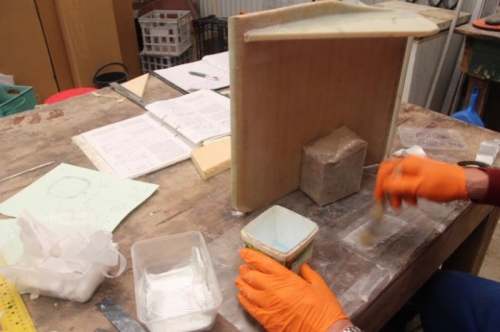

Removed formwork, completed trimming, and taped outboard bulkhead to thigh support, and inbound bulkheads to fuselage bottom and instrument panel. Wet out tapes on peel ply and transferred.
I have pre-cut lots of tapes, with the red indicator thread as a guide. This means the red thread is ALWAYS left behind. From now on I will cut tapes between, or across the threads. I haven't decided which yet.
Taping bulkheads
Taping bulkheads
More taping
More taping
