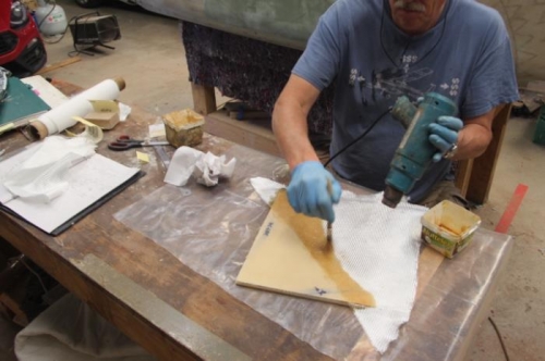

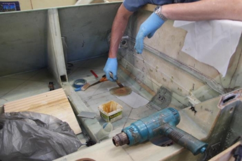

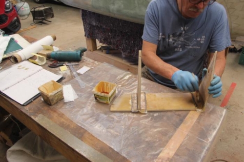

Brief Description:  Sump Tank internal layup
Using AeroPoxy througout, taped the bulkheads together, 1 x BID wet out on the bench and transferred with peel ply.
Found the seat bottom I had cut out some time in the past, and applied 1 x BID on underside and peel plied.
2 x UND inline with and overlapping the bottom layups over the Sump drain and peel ply applied.

Sump Tank drain
Sump Tank drain
Peel ply
Peel ply
Taping, taping
Taping, taping
