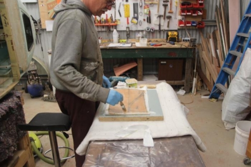

Brief Description:  Sump Tank bulkheads
Marked up foam for bulkheads, tapered the trailing edge of one to clear the center seat belt reinforcement and applied 1 x BID each side with AeroPoxy resin, and pee ply, laid on wet. Still challenging to use this stuff. The shed is warm, but heat is required. I discover the rubber squeegee works really well, like the instructions suggest, whereas it is hopeless with MGS, the glass just slithers everywhere...
Stipple, stipple
Stipple, stipple

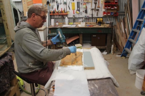

Peel ply, trying to keep it wet
