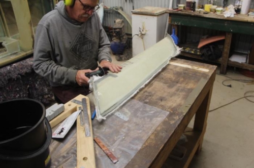

Brief Description:  Right removable Armrest skin
Had a bugger of a time getting the armrest off, stuck like sh1t to a blanket. When it did come it broke off all the locating pins. I made a long drill bit with a bit of tubing and redrilled into the locating pin flange, will reset the broken off pins in these holes.
Ream out the locating pin recieving holes in the fuselage flange a bit.
Trimmy, trimmy
Trimmy, trimmy
