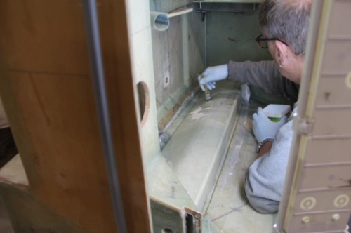

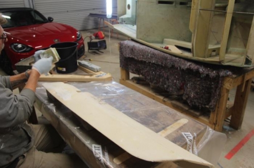

Right removable Armrest skin
Prepped foam on bench then placed in fuselage.
2 x BID overall, overlapping to the cutline.
Prep da foam
Glass da foam
