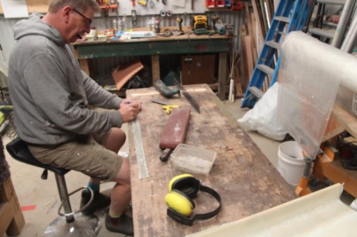

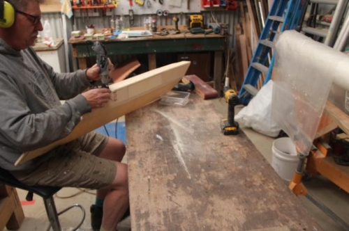

Trimmed & inspected. All good. Drilled and cut up BID clips, destroying form in process, but I probably have enough now.

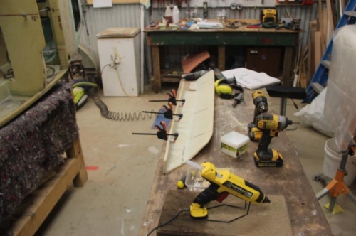

Match drilled locating pin sites and countersunk. Fitted pins with urethane bond and clamped.

Cutting up BID clips
Trimmy, trimmy
Trimmy, trimmy
Locating pins fitted
