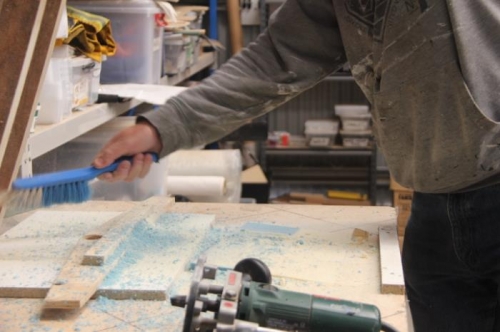

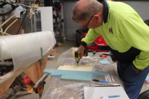

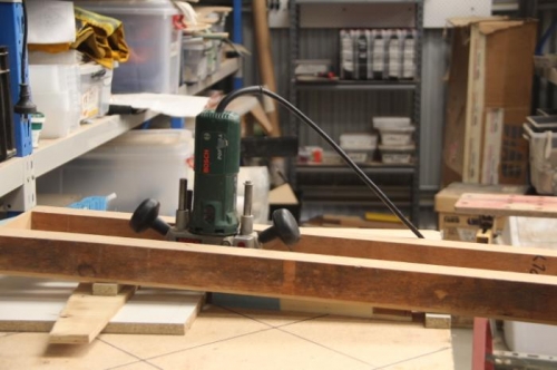

Made a new slopey bottom for the sump tank out of scrap 3/4" H45, extended with 1/4" H100. Assembled with 5-min epoxy and tapered with the Drew Chaplin patented router table thingie.

Assembling the core
Assembling the core
Firing up the router table thingie
Produces perfectly tapered part and a mound of mess
